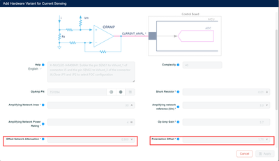

Current Sensing的这两个参数应该怎么填,该如何计算得到,或者有官方文档介绍吗?
How should these two parameters for Current Sensing be filled in? How should they be calculated? Or is there any official documentation available?

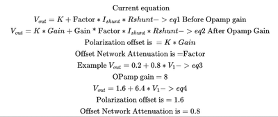

The above is what i followed, V1 = I_shunt*R_shunt.
Check if it is applicable for your configuration.
