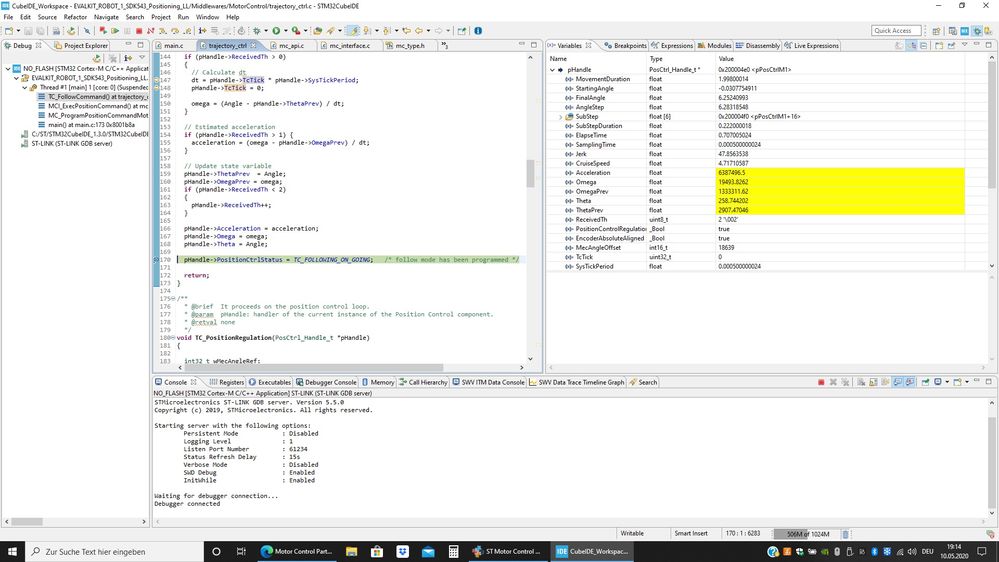

I´ll try to do my best xD Ok, 1st the promised screenshot, while debugging and searching...
As you can see, it stopped at breakpoint in line 170 of trajectory_ctrl.c. In lines 160 and 167, the struct members Omega and OmegaPrev are equally set to the value of the previous calculated (and never altered afterwards) omega variable and therefore should be equal. Also Theta and ThetaPrev in lines 159 and 168 ... Theroretically set to the given function parameter "Angle", which also isn´t altered inside the function. Of course the calculation of "omega" and "acceleration" in lines 150 and 155 rely on ThetaPrev and OmegaPrev ...
Problem here: As far, as i understand the reading of the pHandle struct at the moment, the program stopped, something definitely has happened to the members, while execution.
Correct me, if i´m wrong, but my 1st thoughts went to some other functions, which are able to alter these values, when they are called within an interrupt somewhere between setting them originally and the stop at the breakpoint. It´s very suspicious, that this doesn´t happen all the time. It needs some luck to "catch" that.
At the moment, i took the screenshot, all the original files have been on their original state (exept a) main.c, where i set the target angle and call MC_ProgramPositionCommandMotor1 for the movement and HAL_Delay(1) afterwards , b) the three altered files from the original bugreport) The routines in main are:

​Due to restriction of Covid-19 I can't access in this moment to the lab, but I started to analyze your problem at least on the paper.
I see that you are using the follow mode since you set 0 as duration of the MC_ProgramPositionCommand and you are sendind command at frequency of 1ms that is more or less the same frequency of the Medium Frequency task (basically the freqeuncy of the execution of the position PID) so basically the follow mode of the trajectory is not useful since this trajectory positions are the interpolation of the previous set point to reconstruct the point in between.
Lets suppose that you supervisor (the one that calculate the trajectory) send you command each 10ms and the position PID is executed at 1m the trajectory controller in follow mode is used to estimate the ten points that should be in the middle to give it as reference to the position PID.
If the supervisor give the target position at the same frequency of the position PID there is no need to estimate the intermediate positions.
Another point is that I don't know which are the target points that your code gives to the MC_ProgramPositionCommand, basically because I don't know how the TIM2 is configured and which signals are given in input to this timer. Can you explain the logic behing the computation of the stepPosition and so the fTargetPos or can you caclulate this value by FW so I can verify which values are passed to the MC_ProgramPositionCommand?
Thank in advance
