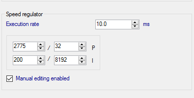

Posted on October 16, 2017 at 09:33
Thanks Hani! I was looking for the issue in the last week. I am very happy, that you said that, I had no more ideas where to search for the issue. I also have a more powerful and bigger motor, than the example.
Altough, I am not a big expert in tuning PI controllers.
This is my controller:
In your motor, what range found out to be sufficent?
Thank you
Daniel
Posted on October 16, 2017 at 11:28
You were absolutely right! After tuning the regulators, the speed ramps works like charm. Thank you!
