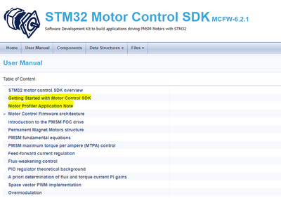

Before going further, could you please read the two highlighted chapters of the documentation:
It will allow you to understand the basics of our solution and how to profile your motor to make it works with our FOC algorithm.
