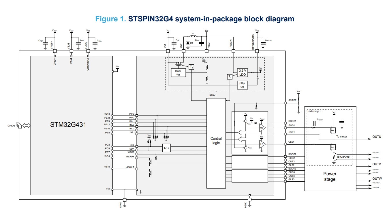

Hello, I need help the product I mentioned EVSPIN32G4 I've been trying for a long time to find the pins on the board to control GPIO signals instead of SPI Interface
I need to find these pins on the board:
I/O control terminal
GND Ground wire
F/R Forward and reverse
EN Start Stop
BK Brake Control
SV Analog input
PG Speed pulse signal output
ALARM Alarm output
+5V Speed regulation voltage output
STSPIN32G4, this is the chip of the board found in EVSPIN32G4
This is the link for the EVSPIN32G4: https://www.st.com/en/evaluation-tools/evspin32g4.html
And that of the STSPIN32G4: https://www.st.com/en/motor-drivers/stspin32g4.html
I use external microcontroller with firmware to control the motor driver its for cnc axes movement application
Regarding the I/O control terminal I mentioned, I don't see that there are exactly the same as in the list I mentioned above, just maybe someone can help me find these pins according to the Block Diagram of the STSPIN32G4
Thanks for help!

    January 15, 2024
    I have added here a picture of the EVSPIN32G4 chip. This is the block diagram. Can you tell me how I can match the list of pins I sent you to the block diagram?Untitled1243.png
    cedric H
    January 15, 2024
    If you are using an EVSPIN32G4 board, then the configuration of the MCSDK follows the schematic of the board and allow you to select all the alternative configurations possible from your hardware. You mentioned that "In the software it is not set up the way I need it."
    Does it mean that the generated software does not work as expected?
    What is your actual need?
    You are talking about pins that are not part of our eco-system, so it is very tough for us to answer correctly.
    GND Ground wire : Are you looking for the ground of the EVSPIN32G4 board ?
    What is F/R Forward and reverse? We do FOC control, the direction of the motor is defined by the PWM duty cycle applied on the 3 phases, there is no pin used for selecting the direction.
    What is SV Analog input ? Do you want to use single shunt or three-shunt config?  By Analog input do you mean ADC input or OPAMP or comparator input?
    EN Start Stop : It looks like the Pin PC13 if you look at the table below
    BK Brake Control : This board uses internal comparator to do over current protection, internally connected to break input.
    PG Speed pulse signal output ? I do not know what this signal is.
    Here is the list of all signals we use on the STSPIN32G4 when mounted on a EVSPIN32G4 board.

    January 15, 2024
    Can u tell me please how i can control of motor speed in board?
    cedric H
    January 15, 2024
    We offer a Motor Control Software Development Kit.
    It means a library with full sources you can use to build your own application on top of it.
    The library comes with a complete set of API that you can call from your application to control your motor.
    On top of that, we developed a UART communication protocol to ease our users to debug their motor setup with a PC Tool : The MC Pilot.
    For the need of a specific ESC-G4 board we developed on top of the library an ESC state machine to control the board from a PWM input signal.
    Now, I do not know what your needs are.
    You can use the UART if you implement the master flavor of the motor control protocol in your host controller. (or develop a lighter version if you do not need a connected protocol)
    Or you can backport our ESC state machine if you have a PWM control input. To do so, you can generate an ESC-G4 project with PWM input control and backport the esc.c file. Be aware that our esc implementation targets drone application, so it controls the speed only in positive direction. This is an application choice; the library allows to control the motor in both directions.
    But you can also imagine sending an analog signal with a DAC on one side and an ADC on the other side.
    Hope it helps.
