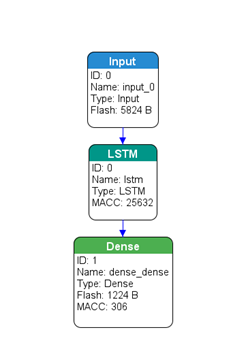

I’m currently trying to upload the following LSTM model into a STM32L476RG via X-CUBE-AI
Uploading the Keras .h5 model works well, however when I try to upload the TensorFlow Lite converted version of the same model, I get the following prompt:
Any ideas about how to solve this problem?

2023-09-05 4:07 AM
I have the same issue with a similar LSTM model. Did you solve it?
2023-10-03 2:47 AM
The conversion to TFLite unfolds the LSTM layer in many different ways depending on the paramters of the LSTM and if it is stateless or stateful.
UNIDIRECTIONAL_SEQUENCE_LSTM is supported by X-Cube-AI, you can follow the instructions here https://www.tensorflow.org/lite/models/convert/rnn to properly convert your Keras LSTM model into a tflite model understood by X-CUBE-AI
Regards

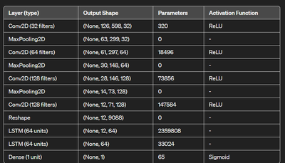

2024-04-19 2:04 AM
I tried the above mentioned solution but still got the same error....
I am also implementing a CRNN model which consists of CNN layers and LSTM layers inside it, but LSTM part is not being implemented.
I am doing audio processing over the board and using LSTM can prove to be very efficient for them.
I have X-Cube-AI 9.0.0, is there any other version I should use? Is there any other way I can work around with LSTM deployment on the board.
My model description:
Here, 128 corresponds to the height of the input spectrogram (frequency bins), 600 corresponds to the width (time steps or frames), and 1 corresponds to the number of channels (mono audio).
Any help is appreciated really,
Thanking you
N.U.Vyas
