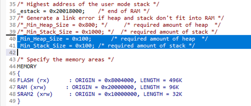

What is meaning of the " region `RAM' overflowed by 4240 bytes" error while compiling ASC source code with STM32Cube.IDE?

arm-none-eabi-gcc -o "B-L475E-IOT01A.elf" @"objects.list" -l:NetworkRuntime410_CM4_GCC.a -larm_cortexM4lf_math -mcpu=cortex-m4 -T"../LinkerScript.ld" --specs=nosys.specs -Wl,-Map="B-L475E-IOT01A.map" -Wl,--gc-sections -static -L../../../../../../../Middlewares/ST/STM32_AI_Library/lib -L../../../../../../../Drivers/CMSIS/Lib/GCC --specs=nano.specs -mfpu=fpv4-sp-d16 -mfloat-abi=hard -mthumb -u _printf_float -Wl,--start-group -lc -lm -Wl,--end-group
c:\st\stm32cubeide_1.10.1\stm32cubeide\plugins\com.st.stm32cube.ide.mcu.externaltools.gnu-tools-for-stm32.10.3-2021.10.win32_1.0.0.202111181127\tools\arm-none-eabi\bin\ld.exe: B-L475E-IOT01A.elf section `._user_heap_stack' will not fit in region `RAM'
c:\st\stm32cubeide_1.10.1\stm32cubeide\plugins\com.st.stm32cube.ide.mcu.externaltools.gnu-tools-for-stm32.10.3-2021.10.win32_1.0.0.202111181127\tools\arm-none-eabi\bin\ld.exe: region `RAM' overflowed by 4240 bytes

2 REPLIES 2
waclawek.jan
It means, that you have too many variables to fit into RAM.
Have a look at the mapfile (B-L475E-IOT01A.map) to see how RAM is occupied.
ChipHead
Please try to change the mininum size of heap and stack as following:
  • File name: LinkerScript.ld
BRs,
Geunsik Lim.
