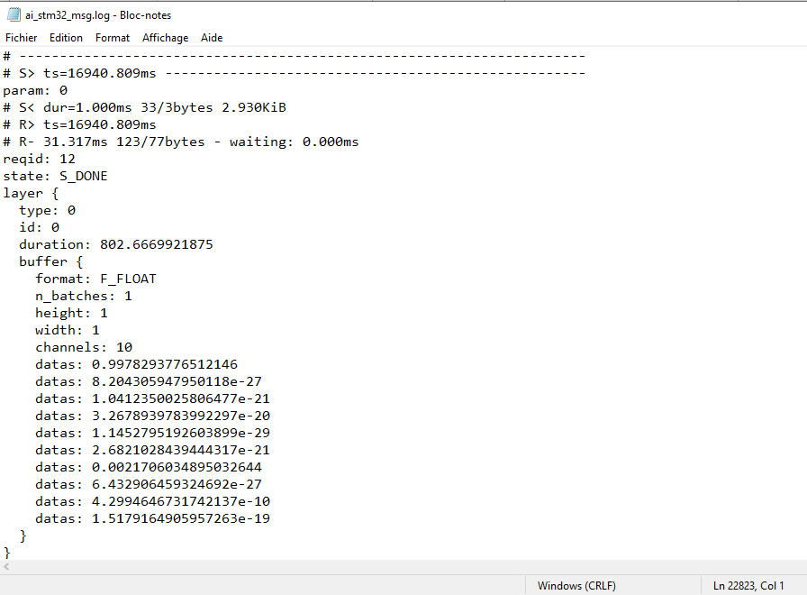

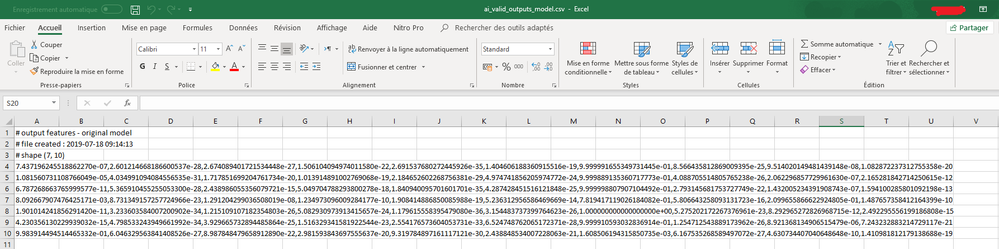

all I can see in the ai_outputs_model.csv and the ai_stm32_msg.log is this :
PS: i used a custom data for cat pictures
Gln
Hi @OGaie​ ,
Great! the ai_outputs_models.csv is the file you should be looking at.
In your spreadsheet, you can see you have 7 rows and 10 columns. Each row correspond to the output of an inference. I'm guessing that the last layer of your classifier model is a SoftMax activation function, in that case, you are getting the probability distribution of your 10 classes.
E.g., for the first row:
7.43e-07, 2.60e-28, ..., 9.99e-01, ..., 1.08e-20 -> index n#6 has the highest value (0.999). The first prediction output is a "6 - frog".

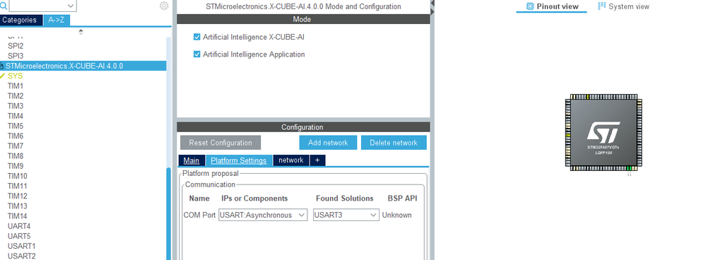

Using the MX Cube AI 4.0 you can see the confusion matrix in the validation on target , so first u need to configure your usart instance and run the cube ai package as validation and load it on your board , then u validate on target (in the mx cube ai interface provided ) using custom data to see if the model is working correctly
Thanks for your answer

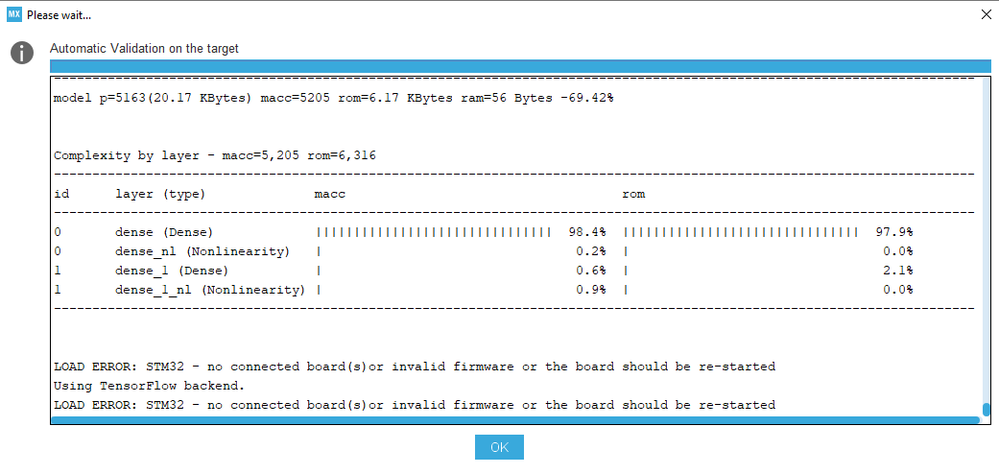

Check your cable if its connected or not and if you are using the usart configuration correctly?
you need to enable the usart from the interface too

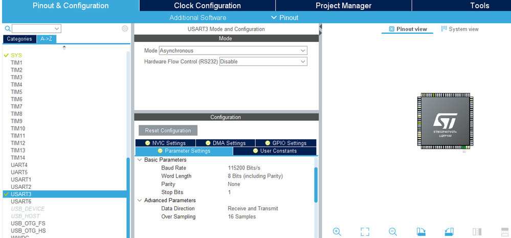

I checked the cable, it is working properly.
Usart settings in the below. Do I need to make any other setting related to usart?0693W000000WHhfQAG.png0693W000000WHhVQAW.png
