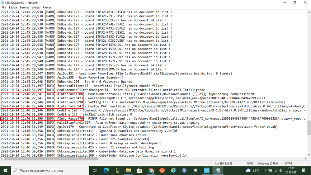

Thank for your answer, I checked logs in the file you mentioned, but I don't know what it mean. I put this file in an attachment and I marked lines connected with AI on the additional screen. Maybe it tells you something and you can tell me where the problem is.0693W00000FDoRcQAL.png

The "interesting part" is this one
2021-10-24 12:46:22,246 [INFO] CmdLine:100 - Command: C:/Users/Kamil/STM32Cube/Repository//Packs/STMicroelectronics/X-CUBE-AI/7.0.0/Utilities/windows/stm32ai analyze --name network -m C:/Users/Kamil/Downloads/model (1).h5 --type keras --compression 1 --verbosity 1 --workspace C:\Users\Kamil\AppData\Local\Temp\mxAI_workspace1200115401730044488494709936223 --output C:\Users\Kamil\.stm32cubemx
2021-10-24 12:46:31,596 [INFO] CmdLine:132 - stm32ai exit with status: 0
On your machine stm32ai command line seems to have execution problems
Can you first rename your model to remove the (1) and the spaces
Then can you try to open a command line and then enter the following commands
cd C:\Users\Kamil\STM32Cube\Repository\Packs\STMicroelectronics\X-CUBE-AI\7.0.0\Utilities\windows
set _DEBUG=1
stm32ai analyze -m C:\Users\Kamil\Downloads\model.h5
Maybe with more debug information we'll know where the problem is
Regards
Daniel

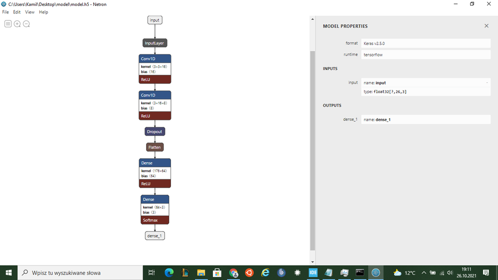

Also you can verify with a tool like Neutron that your h5 is a regular Keras file
HWorl.1
I verified the model in Neutron with the result as in the appendix. Looks like a Keras model. Additionally, I put the result from Neutron and from command line.0693W00000FDp0OQAT.png
