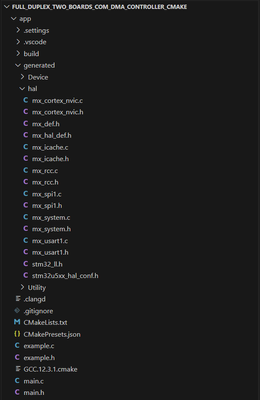

How would I fit with your way of work, if we changed the BSP code with code generated from STM32CubeMX and application code with a clear separation between the two, by having MX generated code in one set of files that the application code calls, in a structure like this?:
