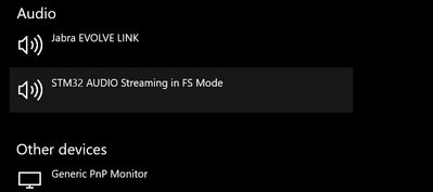

I want to use X CUBE USB AUDIO examples in X CUBE IDE.
After generating the binary code (without errors) and flashing the binary code via DFU, the card is not recognized as an audio device, I tried on all 4 projects. I unplugged USB, do reset, nothink change.
On the other hand, if I generate for example the binary of another audio project: FP-AUD-SMARTMIC1, and flash it via DFU, the card is recognized as an audio device.

Hello @Loulou
Could you flash the code as described in read me? I have run the example, and it works without issues. I can hear through Audio streaming in FS mode using F769 disco board.
