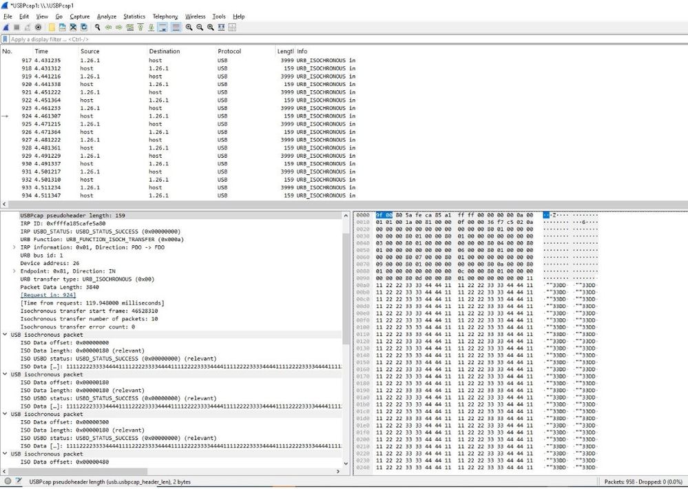

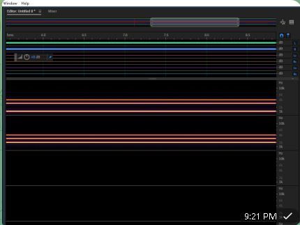

I reuse partly code from memsmic1 project to create 4 microfone audio device. Everything look well for channel 1 and 2 I got some trouble whit CH3 and CH4.  Please help whit    wrong channel mapping for channel 3 and 4. It is mapped on channel  1 and 2  on usb interface. One can see it on attached picture. Here is TLV switched off, SAI(DMA call back) reused for 4 sin generator 1,2,3,4 kHz for every supposed channel. Here you see the picture.
Where i  am wrong?

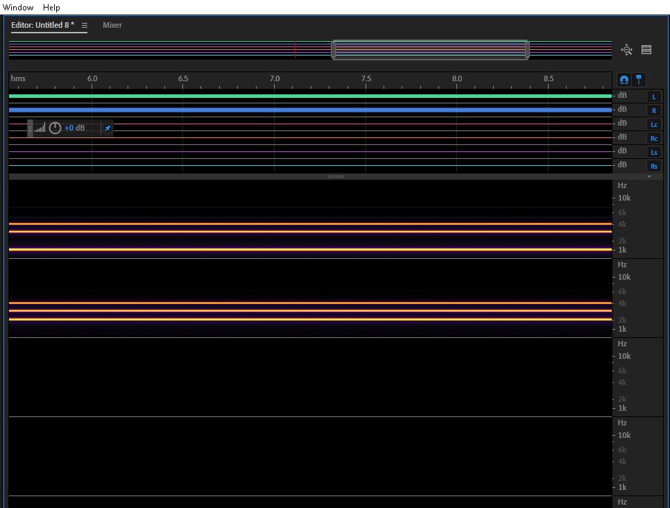

Dmitriy_777
here is better quality picture.

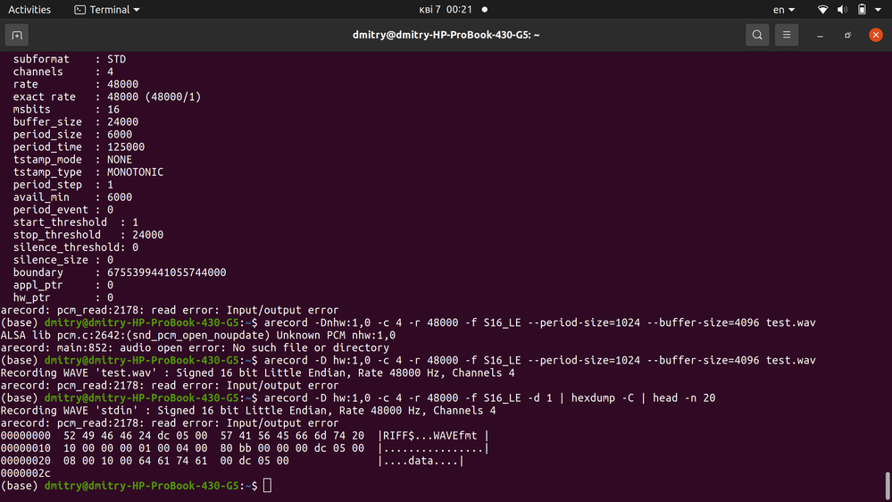

it look like 4 ch going well. linux  also see card but do not what to record. Screenshot from 2026-04-07 00-21-35.png

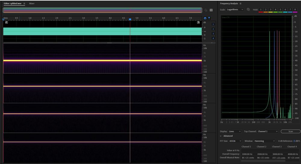

we got result. please stop guys. i resolve 4 channel task

Sure. it was here  + SAI interface settings playing.
  if(Channels != 2)
      USBD_AUDIO_CfgDesc[35] = 0x0F;                                             /* wChannelConfig 0x0F00  4 channels */
      USBD_AUDIO_CfgDesc[36] = 0x00;
    else
      USBD_AUDIO_CfgDesc[35] = 0x03;                                             /* wChannelConfig 0x0003  Stereo */
Question. Could you help whit  new challenge? When i switch  on STM power  whit USB plugged in Windows, everything fine, as soon as take off USB connector and plug again Window see STM  device but no audio data (voice) from STM32. alt_setting changing from 1 to 0. Could you help how to resolve it,? VBUS or CMD_STOP CMD_START?

So the root cause, wChannelConfig was still set for stereo instead of 4 channels. USB Audio middleware and sample code for STM32 generally support stereo (2-channel) configurations by default. User need to configure it manually. Configuration for multi-channel streaming requires both hardware and firmware modifications.
Linux is often more tolerant of USB audio descriptor oddities than Windows.
So if the stream data and packet size are already correct, Linux may still record successfully even when wChannelConfig is not ideal.
