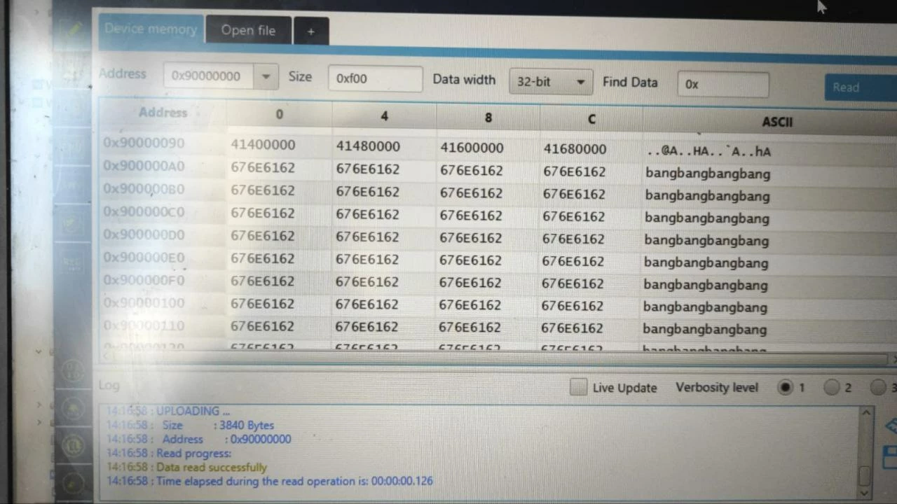

and here what only 1 ieteration of flash_write (while debugging) saves
Worth also mentionning that outside of thoses for(;;) loops everything works correctly, I a priori also cannot fix my problem simply by removing the for(;;) loop because it's inside a FreeRtos task

How do you know only one iteration took place? Looks like you're debugging in STM32CubeProgrammer. Would be more useful to step through in STM32CubeIDE. Or write code that actually only executes a single loop. The code posted is consistent with the results you show.
frontinusAuthor
October 6, 2024
I'm debugging step by step from stm32 cubde ide, I put a breakpoint at the for cycle, then take 3 steps over with the debugger, interrupt the debugging and open prg to see what's inside the flash. Isn't that 1 iteration?
October 6, 2024
The transition from debugging in STM32CubeIDE to connecting with STM32CubeProgrammer requires that the debugger be disconnected first, which lets the code free run.

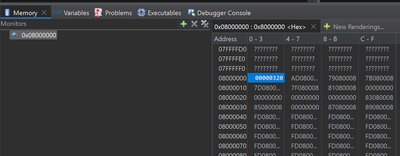

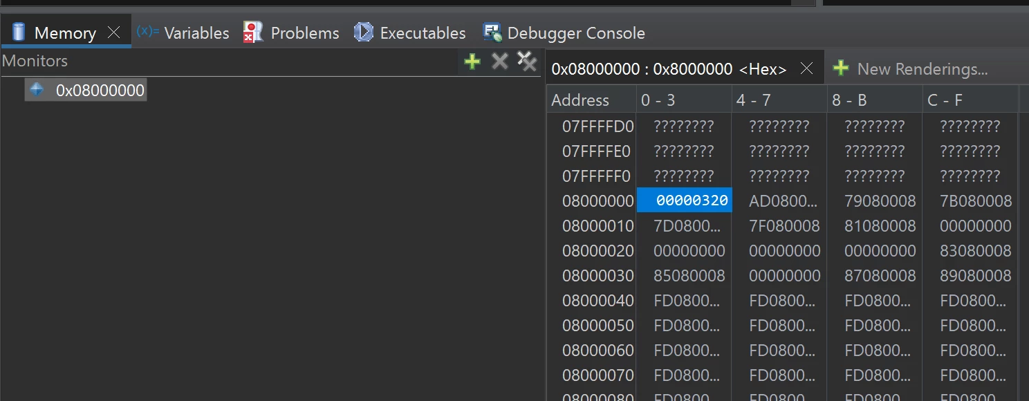

Use the Memory viewer in CubeIDE (Window -> Show View -> Memory) to do the same thing while debugging.
I would initialize the memory with 0x00 and verify at the start of the loop that the memory isn't already written with "bang", then execute one iteration and verify the results. If it writes more than once it's a logic error in Flash_Write that you should be able to track down.
