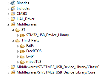

I would debate that, because ST do "offer" the whole thing: USB, FreeRTOS, ETH, LWIP.
They just chose to not integrate them properly. It's in bits around the place. Espressif OTOH did pay somebody to integrate all this and it works out of the box. Not bug free (some subtle bugs in their TinyUSB code) but a lot easier.
I would still use ST for commercial reasons (e.g. likely production life of 20 years on these "industrial" chips, chinese political risk on the key component, etc) but I can see why people go the ESP32 route. They save themselves a year of intense R&D.
BTW, my project started off as a hardware (circuit diagram) copy of an ST devt board (almost everybody does that) but still a vast amount of work was needed to get it to work properly.
