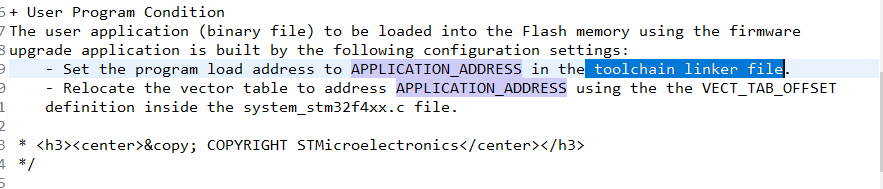

Hello everyone, when I was watching the stm32f429 routine, there was an example of upgrading the user program with the U disk. It was mentioned that the configuration of the user program needs to change the contents of the [toolchain linker file]. Where is the [toolchain linker file]?0693W00000QOGveQAH.png

A .LD file under the project directory describing the memory available for the linker to use.​

OK,thank you�?​
