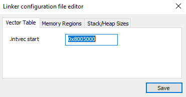

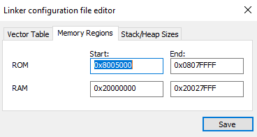

Most time i use IAR to create an application. But want to use mingw and vs code instead iar. I`m already have a bootloader which is working fine with my IAR applications.
Here is the sequence for IAR:
  1. I generate project for IAR via CubeIDE
  2. In IAR i go to options->linker and change vector table and memory regions
  3. Insert this code in main():
  __disable_irq();
 SCB->VTOR = 0x8005000;
 __enable_irq();
4.download app with bootloader and everything working fine. Even i can debug my application
