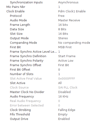

I am trying to configure a single microphone with a pulse-density modulation (PDM) output on my microcontroller (STM32U575ZIT). It's a CMM-4030DT-261280-TR MEMS microphone.
But I can't seem to figure out the basics. The SAI settings mention "Frame Length", "Data Size" and "Slot Size". What even are slots and frames in this context?
I think I understand PDM and it makes sense to define a data size: how many bits should be counted together to form a single data point. The other notions however confuse me.
Attached is my SAI config from CubeMX.

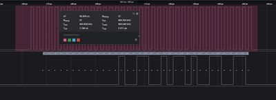

I logged the clock and data using a logic analyzer some testing code on the MCU hoping to figure this out. The code:
            HAL_SAI_Init(&hsai_BlockA1);
            std::array<uint8_t, 8> data;
            data.fill(0);
            auto ok = HAL_SAI_Receive(&hsai_BlockA1, data.data(), data.size(), 100);
            HAL_SAI_DeInit(&hsai_BlockA1);
The analyzer output and the content of data after this block:
For one I am surprised to see 37 rising edges, instead of 8 * 8 = 64. How where these bytes composed?

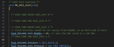

Figured I'd come back with the full solution. In the end I got a single PDM microphone to work with these settings:
Only the Mckdiv value I couldn't manage to change from CubeMX, so I added that as user code:
In the end the "Serial audio interface (SAI)" chapter of the STM32 reference manual was helpful. In particular the section "PDM interface". See also the following figure from the manual:
So the PDM data is collected by the SAI and written to memory as 'slots'. The memory destination (SAI_ADR register) is always divided in 32 bit words and you can configure how these words should be used.
With the config above, only the smallest 8 bits of each WORD are filled by the single microphone. But the HAL functions neatly take care of this behavior, so as a user you only the see the byte produced by the

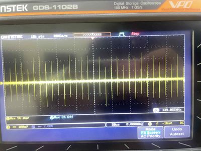

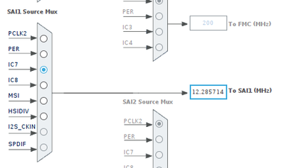

Hello, i am connecting mp34dt01-m one microphone to the NUCLEO-N657X0Q, and my SAI1_CK1 is unexpectedly like around 100KHz.
Here is my configurations below, can you help?
Also, added this after generating:
hsai_BlockA1.Init.Mckdiv = 12;
