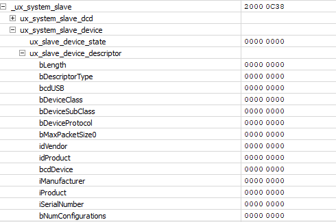

Following the example in STMCubeMx Azure USBx CDC ACM. it seems that I'm having trouble when the PC does not recognize the USB device slave giving me this error
the there is no error in the app_usbx_device.c initialization, in terms of memory allocation. during debug, checking the _ux_system_slave handle it seems that the slave descriptor is not set.
I don't think this normal not have the device descriptor populated. I don't think there is a problem with the hardware since I run tinyusb on this device no problem. since I'm migrating to azure RTOS its nice to use the USBX as well.

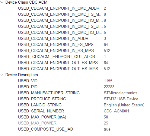

CubeMx USBX config

Hello @Rhyzack​
You can refer to the following example provided under the X-CUBE-AZRTOS-F4 package:
- Path: Projects/STM32469I-Discovery/Applications/USBX/Ux_Device_CDC_ACM
Otherwise, could you please provide the ioc file used for further check?

anyone else having this issue. attach the .ioc file and check if the configuration is correct. i dont find anything wrong with it. it seems this is bug or something
