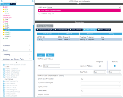

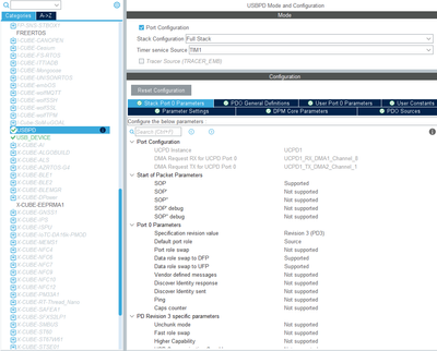

I have generated a code from CubeMX for USB-PD in bare-metal configuration like this:
