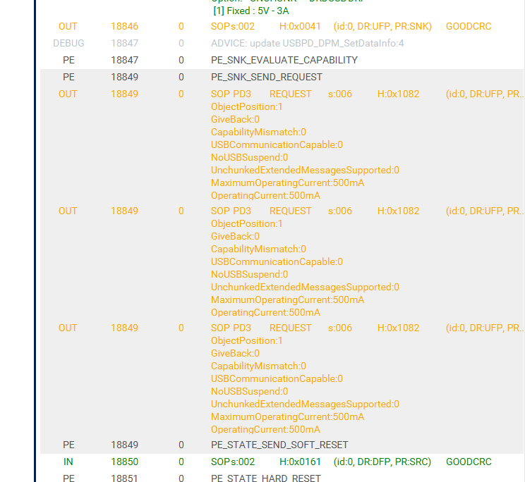

I have an USBPD sink application created with CubeMX that can be found here:
https://github.com/ThiRom/H563NucleoUSBPDSink
The project can be build using cmake. If the project is build using Debug configuration, it works. But using Release it shows timeouts on requests. As you can see below during one millisecond the firmware sends 3 retries and a soft reset.
This problem can be seen with -O2 and -O3 option. It seems that the file usbpd_timersserver.c is not working correctly. I found that function:
uint32_t USBPD_TIM_IsExpired(TIM_identifier Id)
  uint32_t _expired = 1u;
  switch (Id)
    case TIM_PORT0_CRC:
      _expired = TIMX_CHANNEL1_GETFLAG(TIMX);
      break;
    case TIM_PORT0_RETRY:
      _expired = TIMX_CHANNEL2_GETFLAG(TIMX);
      break;
    case TIM_PORT1_CRC:
      _expired = TIMX_CHANNEL3_GETFLAG(TIMX);
      break;
    case TIM_PORT1_RETRY:
      _expired = TIMX_CHANNEL4_GETFLAG(TIMX);
      break;
    default:
      break;
  return _expired;
 When I change it to this:
  switch (Id)
    case TIM_PORT0_CRC:
      break;
      _expired = 0;
      break;
    case TIM_PORT1_CRC:
      break;
      break;
    default:
      break;
  return _expired;
It works.
Any idea how to fix it correctly?

Hi @RomThi
I think the issue is how the return value _expired is used and how the optimizer sees it, especially inside tight loops. _expired should be either 0 or 1. So I propose the following,
      _expired = (TIMX_CHANNEL2_GETFLAG(TIMX) != 0u) ? 1u : 0u;
      break;
_expired initialized to 0 instead of 1 (default should be not expired). Let me know if this does help.

RomThi
thx for your fast response. I have tried what you send without any change.
I also tried this:
      return ((READ_BIT(TIMx->SR, TIM_SR_CC1IF) == (TIM_SR_CC1IF)) ? 1UL : 0UL);
Still no change.
Best regards,
Roman
@RomThi Still waiting for dev team feedback,
You can instrument USBPD_TIM_IsExpired as noinline or lowering optimization on this function as a safety measure
__attribute__((noinline, optimize("O0")))
 Which compiler are you using? The issue is being tracked internally under CDM0060354 for internal reference only.
Best regards,
FBL

RomThi
Hi, I have checked this:
  * @brief  check timer expiration
  *   timer id _identifier
  * @retval None
  bool _expired = false;
  switch (Id)
    case TIM_PORT0_CRC:
      break;
      break;
    case TIM_PORT1_CRC:
      break;
      break;
    default:
      break;
  return _expired;
But there was no change. My compiler is:
C:\ST\STM32CubeCLT_1.17.0\GNU-tools-for-STM32\bin>arm-none-eabi-gcc.exe --version
arm-none-eabi-gcc.exe (GNU Tools for STM32 12.3.rel1.20240926-1715) 12.3.1 20230626
Copyright (C) 2022 Free Software Foundation, Inc.
This is free software; see the source for copying conditions.  There is NO
warranty; not even for MERCHANTABILITY or FITNESS FOR A PARTICULAR PURPOSE
It seems the function is optimized out as it is called from the library only.
Best regards
Roman
