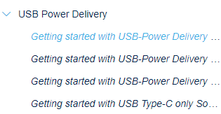

I would like to add, in USB PD wiki we have 4 step by step useful examples for different modes if interested.
Best regards,
