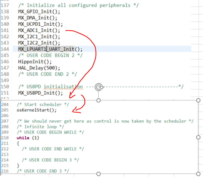

My problem is:
  • when I power my STM32, I don't know the power supply to STM32 is from Adapter or Vbus of Phone ( because ADC init and convert slow, when app task run I can know )
  • If I want my Port is source, I must wait cable connect and change to source by PowerRoleSwap ( because default is Sink )
Can I change my port is source even no cable connect?
