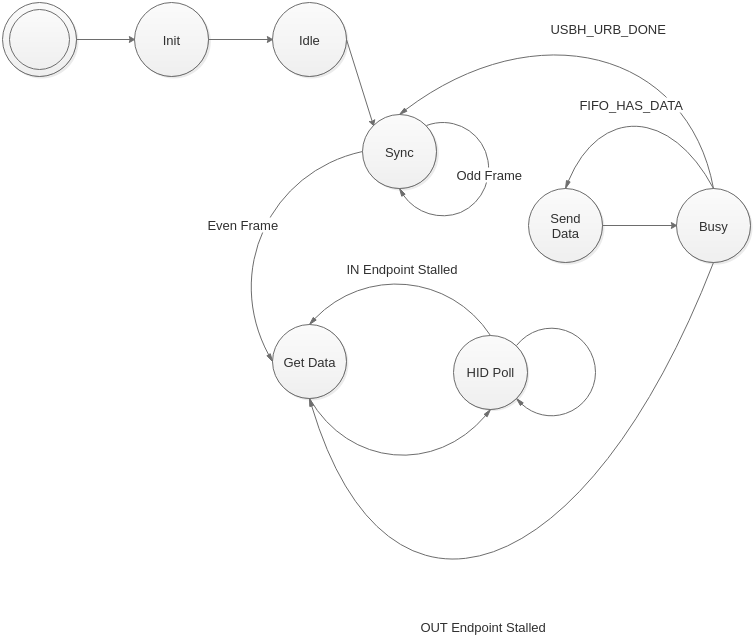

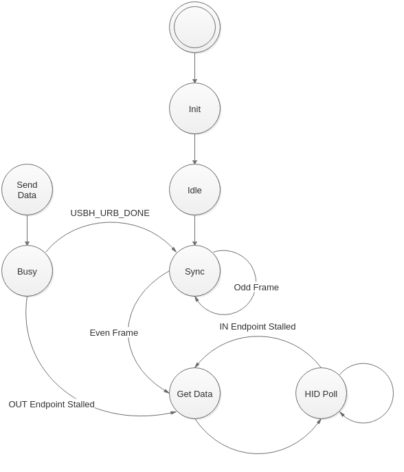

Modifying the ST USB Host library to include the missing states in the
static USBH_StatusTypeDef USBH_HID_Process(USBH_HandleTypeDef *phost)�?�?
method that runs the HID Class.
SEND_DATA - for sending packets TO the HID device
BUSY - used as a polling state after data sent.
Wondering if the USB experts on here can look at the state transitions and validate the state and transition correctness.
The last question is Data0/Data1 toggling. It appears that is happening somewhere in a lower level. Do I need to manually toggle the Data0/Data1 in the state?
#usb-hid #usb_hostSolved! Go to Solution.

2018-05-17 10:01 AM
Or for larger than single frames:
2018-05-28 12:52 PM
static void HCD_HC_OUT_IRQHandler (HCD_HandleTypeDef *hhcd, uint8_t chnum)�?
Tested. The above state transitions work with the existing ST HOST USB Library. However, I did find that the OutPipe does not toggle the Data0/1 line like the InPIpe does. Bug? Adding a data toggle after a successful frame transfer solved the issue.
case HID_BUSY:
if(USBH_LL_GetURBState(phost, HID_Handle->OutPipe) == USBH_URB_DONE)
USBH_LL_SetToggle(phost, HID_Handle->OutPipe, 1 ^ USBH_LL_GetToggle(phost, HID_Handle->OutPipe));
Confirmed: Out Interrupt handler doesn't implement an Interrupt transfer data toggle.
