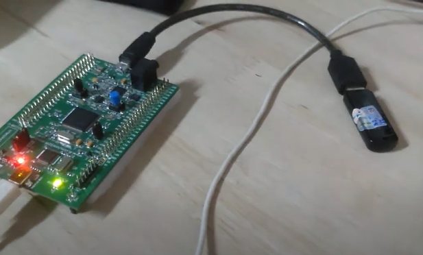

USB host firmware upgrade stm32f7 series
N Sornakumar
Board name : stm32f746g discovery
I need to update firmware through usb host, i did not get any documents for "stm32f7 series usb host firmware upgrade"
does any one help me ?
For example i need this type firmware upgradation:(it takes from internet)

Hello @N Sornakumar​ ,
You can refer to the following example provided under our F7 CubeFW :
  • Path: Projects\STM32756G_EVAL\Applications\USB_Host\FWupgrade_Standalone
I hope this helps you.

N Sornakumar
Hello @Walid ZRELLI
. I have an application which is running properly at the starting location i.e
0x0800 0000
(after usb boot)
. If I change the starting location to
0x0800 4000
 the application is still running this location 0x0800 0000
So my bootloader not working ??
