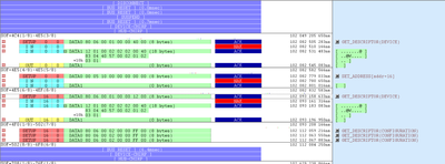

With a USB protocol analyser, I got this when High speed is set: Got stuck in with device configuration
Chirp, passation of data with address setting and device descriptor seems to work
And This is Full Speed: Works fine

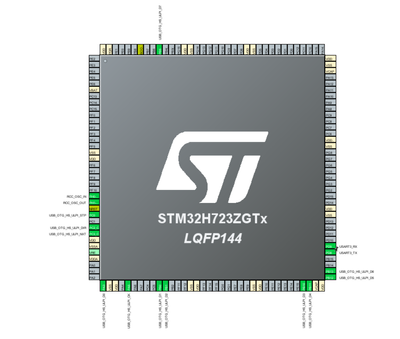

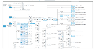

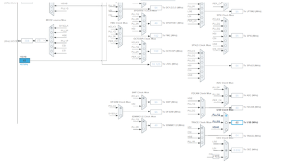

Is the ioc file good enough?
Here are some pictures of the clock.
I'm working with a Nucleo Board H723ZG and for HSE, use the 8MHz from the STLK_MCO.
My constraint with the clock is that I am planning to the FDCAN module with 96MHz from PLL2Q.
Hi @RichFarmer ,
if you are using our Nucleo, I assume using some flying wires to hook the signals to the USB3300 or my understanding is wrong .  I would suggest to run the default examples of High Speed USB keeping the same Clocks configuration before changing them to your requirements.  Also to check how the 60MHz going to the PHY is generated?

The setup starts. Chirp is recognised as HS. The device sends its descriptor and receives an address from the host. The device then resends its descriptor using now the address attributed by the host. The device tries to send its configuration but doesn't get any ack or nack and the setup fails here.
So far, the data that I can read in the descriptor (PID, VID, etc..)with the protocol analyser looks like my settings. So, since the data is "partially" correctly recognised, I would like to go through the setup...
If anyone could direct me to the function or part of the program handling the communication or setup of the device, it would be helpful.
Thanks
PS:If it may help: a picture of the protocol analyser result and the data in the descriptor(device)

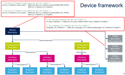

FBL
Hello @RichFarmer
Sorry for not reaching out sooner. About your last question, at device descriptor level, you can get device framework for high speed within you can get the length and  string_framework
Best regards,
