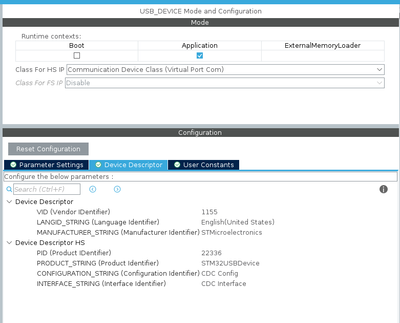

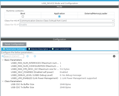

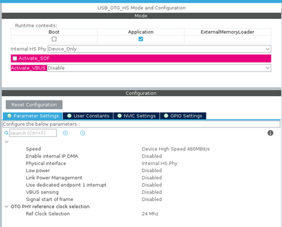

These are my configurations of USB:
The Global Interrupt for USB is also available.

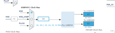

This is the clock configuration:

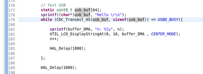

This is my code at the main, I just developed a code to send "hello" every second, and if it is Busy, it will print an increment value on the LCD

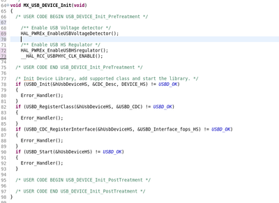

This is my  USB init function:

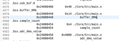

Where is usb_buf located? Somewhere the USB DMA can access?
The usb_buf is located at  0x24000400
Can USB access it, right?

I already solved the problem. I enabled the cache, but the problem was related to opening the serial port at TIO to communicate with my computer.
Thanks for the support @TDK .
