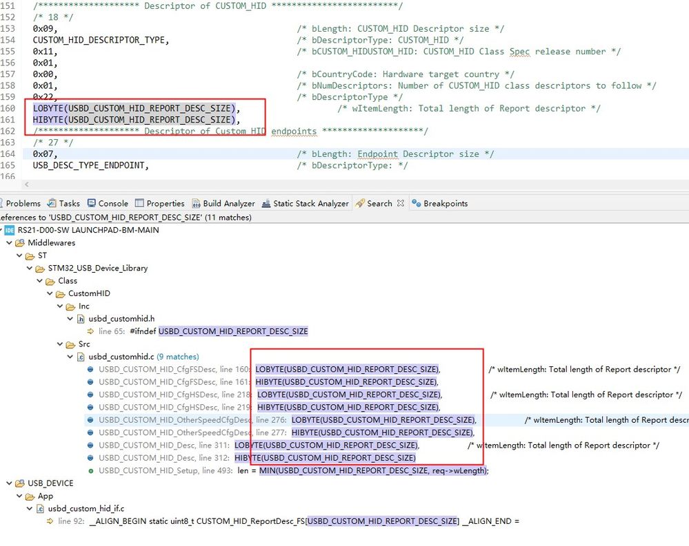

I have a report descriptor that consist of 456 bytes. The problem is : When i define USBD_CUSTOM_HID_REPORT_DESC_SIZE   456 in usbd_conf.h file, it raises overlow warning and my hid device no longer works. How can i define hid descriptor size bigger than 255?

The size is 16 bits. Somewhere it's getting truncated to 8 bits - check where.
-- pa

​I changed it from {USBD_CUSTOM_HID_REPORT_DESC_SIZE, 0x0} to {LOBYTE(USBD_CUSTOM_HID_REPORT_DESC_SIZE), HIBYTE(USBD_CUSTOM_HID_REPORT_DESC_SIZE),}. it doesn't worked.0693W000008xrKsQAI.jpg
