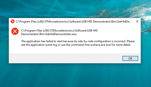

I am working on nucleo-h745ziq board.Interface the usb as custome HId. I try to install the USB HID Demonstrator but it throws error .There is another terminal so I can use ? Please help me

Hello, i have this error too. So i download " Microsoft Visual C++ 2005 Service Pack 1 Redistributable Package MFC Security Update" from microsoft and Install (vcredist_x86.exe) (vcredist_x64.exe).Now everything worked!

Can you please precise the error message you have (if possible share screenshot) ?

First time i am using the windows 7 it operates on that but when i tried to install on the windows 10 it shows this error to me.

The Solution suggested by YLive.1 is working fine for me on Windows 10.
