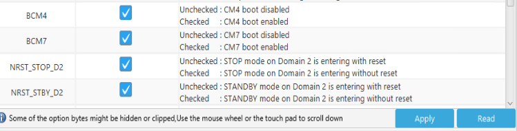

I am using STM32H745XI having Device ID: 0x450, Revision ID: V, Bootloader version: 0x90.0693W00000Unt4kQAB.pngI have pulled high Boot(pin), which is causing inbuilt bootloader to get executed. Both cores boot are enabled i.e. BCM4 & BCM7 are checked.0693W00000Unt5iQAB.pngOver i2c, I am able to communicate with bootloader and getting proper response for bootloader version, memory read/write command and go command.

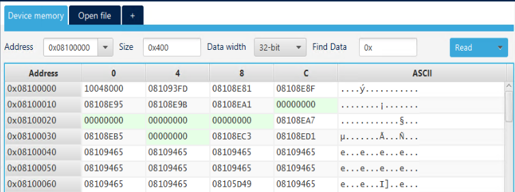

ACK is also received, but flash code is not getting executed (both 0x08000000 & 0x08100000, code are loaded).
 0693W00000Unt83QAB.png0693W00000Unt7tQAB.pngJust to check the Flash code, I pulled down the Boot(pin) and observing both the cores behaving as per code.
can you please help me if i am missing anything in executing the code from flash.

Hello @Vijay Pratap​,
Please check AN4221, 2.5 Go command section.
Make sure that the vector table is set correctly to point to the application address.
