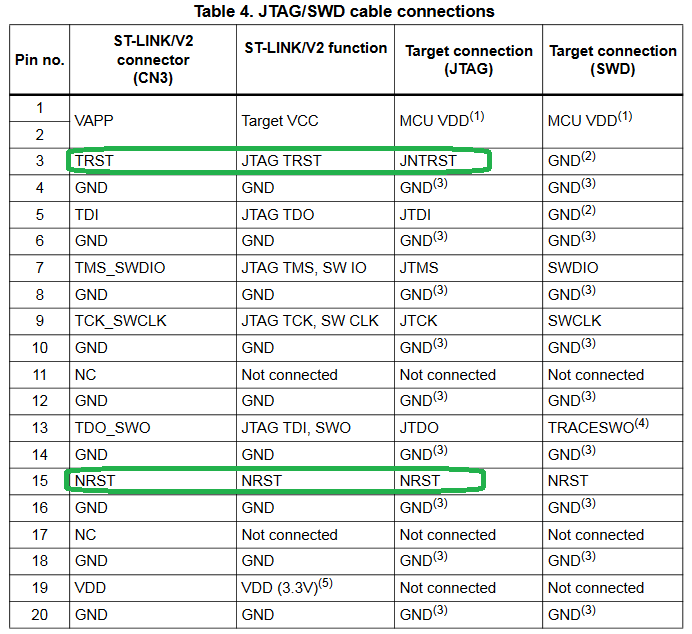

tom239955_st
April 10, 2017
Posted on April 10, 2017 at 19:08
Some useful pointers. I am struggling to find a consistent hardware refererence design for the USB. Any suggestions of docs and/or links? If it were a USB hardware circuit problem do you think having the ST-LINK would solve this and allow it to work - it really is a strange one.
The ST-LINK is connected to VCC which in my case is +3V3.
Regards,
Tom
Tesla DeLorean
Guru
April 10, 2017
Posted on April 10, 2017 at 21:15
The ST-LINK (external) has its buffers powered by the Target (VTref), and provides power via Pin 19 (3.3V). Back feeding of current might preclude odd reset/startup states.
What it does with the NRST pin might of more interest. The STM32 should threshold the supply on VDDA, and drive the reset. I'd want a 10 or 15K pull-up on NRST.
http://www.st.com/content/ccc/resource/technical/document/user_manual/65/e0/44/72/9e/34/41/8d/DM00026748.pdf/files/DM00026748.pdf/jcr:content/translations/en.DM00026748.pdf
Try wiring the JTAG using individual jumper wires, and make a determination about which pin is causing headaches.

tom239955_st
April 10, 2017
Posted on April 10, 2017 at 21:27
What is 'VTref'?
What do you mean threshold the supply?
I do not have NRST pin on the MCU connected to anything other than a 100nF capacitor! I have connected the NRST pin (15) on the ST-LINK to the 'sys_njtrst' on the MCU.
BOOT0 normally pulled low via a 10K, shorted to VDD for System Loader boot.
Is this not the other way around?
Tesla DeLorean
Guru
April 10, 2017
Posted on April 10, 2017 at 22:03
Voltage Target Reference, what you're system runs at 2.7V, 1.8V whatever
http://infocenter.arm.com/help/index.jsp?topic=/com.arm.doc.dui0517b/Cjaeccji.html
Power-On Reset circuit watchs for a transitional voltage, in external circuits often a laser-trimmed part, holding a 3.0V system clamped in reset until the voltage ramps above 2.7V. Ensures a proper/effective reset of synchronous logic which might start being semi-functional at 1.2V
Like I said 'I'd put a pull-up on my designs', consider it as constructive suggestion.
NRST != NJTRST, one is the MCU reset the other is a JTAG system reset.
No, you'd normally want BOOT0 low so it runs YOUR code, don't leave the pin float. When you want the System Loader to work the pin must by High, test fixturing of a normal board, with it pulled low, simply drives/connects to VDD/VCC to get it into that mode. If you use a button, button shorts to VDD, otherwise normally pulled low.
tom239955_st
April 10, 2017
Posted on April 10, 2017 at 22:15
My mistake, this is what I have.
So, you would recommend pulling the MCU NRST pin high - note :)
Now, am I correct in connecting the ST-LINK NRST to NJTRST? or is that to be connected to MCU NRST?
Tesla DeLorean
Guru
April 10, 2017
Posted on April 10, 2017 at 22:21
NRST goes to NRST (NRESET), the CPU
NJTRST goes to NJTRST, honestly not required for SWD connectivity.
For SWD, you want VCC, GND, SWCLK, SWDIO, SWO, NRST
