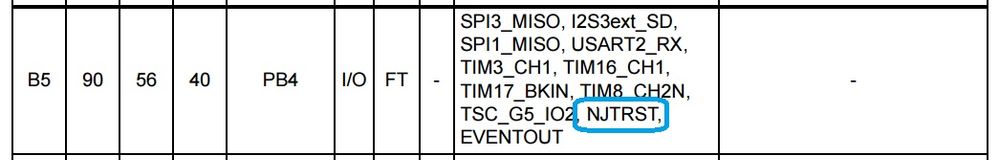

I am using STM32F303CCT6 on my own board. During testing I noticed that USB DFU works fine and is detected by the PC, but ONLY when the ST-LINK/V2 is also connected ... When it is not connected the DFU does not show up on my PC?
I performed a sanity check and my code runs as expected without the ST-LINK/V2 connected, its just that the USB DFU is not found be the PC without it ...
Any suggestions or things to check?

I have corrected the NRST wiring and that has not solved the problem.
However, I took your second advice about jumping the ST-LINK and I have found that when both the TVCC 'AND' SWIO pins are connected the PC sees the DFU ....
Any thoughts?
‎2017-04-11 8:11 AM
I have found a solution to this .... but seen nothing in any of the documentation!
I have pulled-up the TMS/SWIO pin to +3V3 using a 10K resistor. The PC now sees DFU mode and the ST-LINK still can program the MCU.

What about RM0316 Chap. 33.4.3 'Internal pull-up and pull-down on JTAG pins'
There is a clear statement that TMS has an internal pull-up. Probably you have a load on your TMS pin, pulling down.
