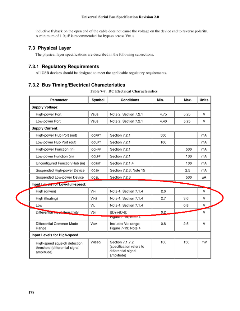

I saw in the datasheet that the max USB voltage input for the STM32F072C8T6 is approximately 3.6 V. Since the USB data voltage can go up to 5 V, I was wondering how one would make the connection between the USB to this MCU. If a voltage translator is required, could you please recommend one for this MCU?
Or, am I incorrect and you can get away with just directly connecting the USB to the MCU USB data lines?
No, it can't.
And no worry, even if there's some short on the cable: the DM/DP pins are 5-volt tolerant, see the pins table (they are FT type).
Btw. VDDIO2-USB transceiver operating voltage specification is for the *supply* voltage to the USB transceiver.
