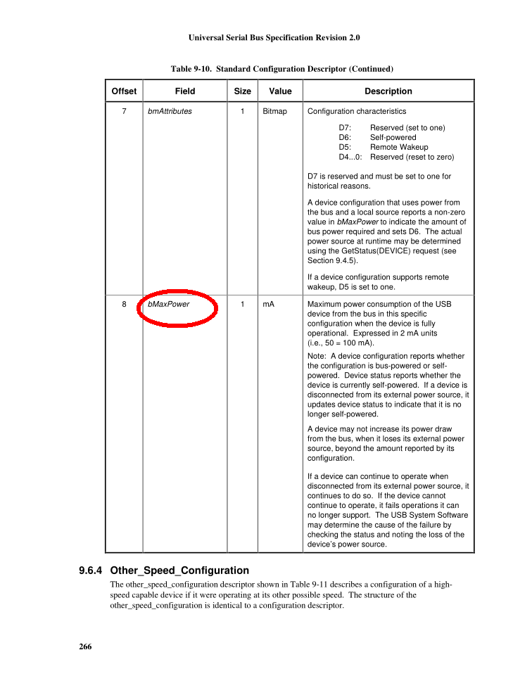

Does the STM USB CDC driver support power negotiation? If so please could someone point me to where I configure a request for more than the default 100mA.
I'm using STM32F407 and CDC is working nicely but the computer only shows that 100mA is requested. I need more than this to power peripherals which will be attached to the uP.
Any help appreciated
waclawek.jan
USB devices request current through the bMaxPower field in the standard Configuration descriptor, so simply change it there.

waclawek.jan
Peter Mather
Thanks - took a bit of time to find as the field name misses the "b"
from usbd_cdc.c
__ALIGN_BEGIN uint8_t USBD_CDC_OtherSpeedCfgDesc[USB_CDC_CONFIG_DESC_SIZ] __ALIGN_END =
  0x09,   /* bLength: Configuation Descriptor size */
  USB_DESC_TYPE_OTHER_SPEED_CONFIGURATION,
  USB_CDC_CONFIG_DESC_SIZ,
  0x00,
  0x02,   /* bNumInterfaces: 2 interfaces */
  0x01,   /* bConfigurationValue: */
  0x04,   /* iConfiguration: */
  0xC0,   /* bmAttributes: */
  250,   /* MaxPower 500 mA */
