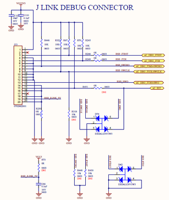

            My name is G. Sai Deepak. In our railway project, we are using the STM32G4A1VET6 microcontroller. This is how we have designed and connected the microcontroller in the schematic. I kindly request you to review the schematic and let me know if any changes are required

Looks okay to me at a high level except that I don't see a programming header. Presumably that's somewhere.

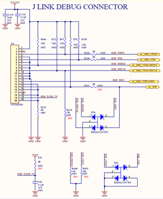

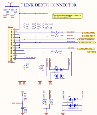

Hi, This is the programming header we have used for our project which is a J-Link Debug Connector, Once check it and review it from your side

Hi, This is our programming header Could you please review it and give your feedback.

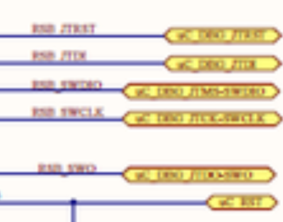

Two things:
Here's your image blown up. It is painful to read due to being nearly illegible. A PDF would be better, or a high resolution image.
I don't use JTAG so would rather not weigh in here. The programmer manual should detail what connections are needed.

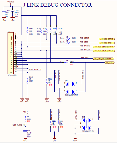

Hi, Thanks for the response. I hope now you get clarity on the Programming header image used in our schematics so, Please Review it and provide feedback

We are using SWD for STM32H743BIT6
Looks roughly okay, though a lot of those pins are not needed for SWD. Does it match the pinout in the programmer user manual?

Hi, Thanks for your response Yes, it's Matching and we are following the Pin out from the below mentioned Link and I have mentioned the pic of the section that we are following
