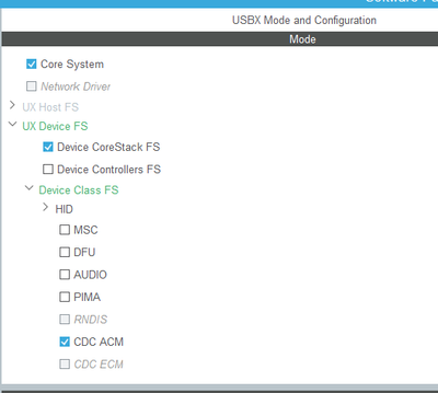

tried to set up a USB device serial emulation (CDC) for STM32H563. Started a Free RTOS based project project in STM32CubeMX. But there I only can activate USB as "device_only in the "connectivity" segment but do not find any other USB related settings. I did that previously with the stm32F series and there it was in STmCube, no prob.
The generated code also seems not to have the USBD_DESC_Private_Defines or similar things needed.
Is it somewhere hidden under another name in STM32Cube? Or does STM32Cube does not support it? Or is this  CPU issue? Or do I need to somehow get me drivers from other places and when yes, from where?

You are invited, to use Azure /ThreadX . :)
Here (threadx activated) you can choose ... :

Hi @VKoen.1
Which USB stack do you want to implement? If you are using ST Library stack, it is not implemented in CubeMX. You can check examples provided here.STMicroelectronics/stm32h5-classic-coremw-apps: Provide a set of applications for STM32H5xx series based on the STM32 Classic Core Middleware libraries. (github.com)

VKoen.1
Just to close this topic:
I got it running on a stm32H563 following STM advice
https://community.st.com/t5/stm32-mcus/how-to-use-stmicroelectronics-classic-usb-device-middleware-with/ta-p/599274
The only weak point was, that I had to switch off the ICACHE, probably because of a weakness in the STM code concerning read out of CPU serial number, but I did not need the speed, and so I was good
