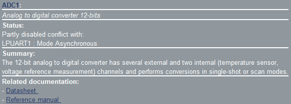

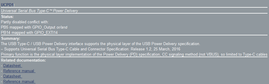

Hi All, I followed the updated ST tutorial on Youtube for setting up USB-PD (https://www.youtube.com/watch?v=-vsJhNIaHxE) and I can't seem to actually get it to show up on the STM32CubeMonitor-UCPD app after following as closely as I could. I am designing on a NUCLEO-L552ZE-Q and the latest version of STM32CubeIDE 1.7.0 and I wasn't sure how this would impact the items I needed to change when setting up the project as compared to using a different eval board and STM32 series MCU.
I noticed that a few pins would be set already when I started the project. After configuring all the same parts in the .ioc file, I did end up with some status warnings on ADC1 and UCPD1 peripherals.
All the code was the same as is seen in the video and I was able to build and program without any errors.
Is there anything I need to tweak differently from the STM32G0 USB-PD tutorial and my STM32L5 eval board? Also should I be trying to get rid of these status warnings?

STM32CubeMonitor-UCPD program is used through VCP link available with ST-Link connector (USB).
Does not care about this warning... it is not used for our purpose.
As you work on NUCLEO-L552ZE-Q nucleo board, the application should work with application available in the FW package.
