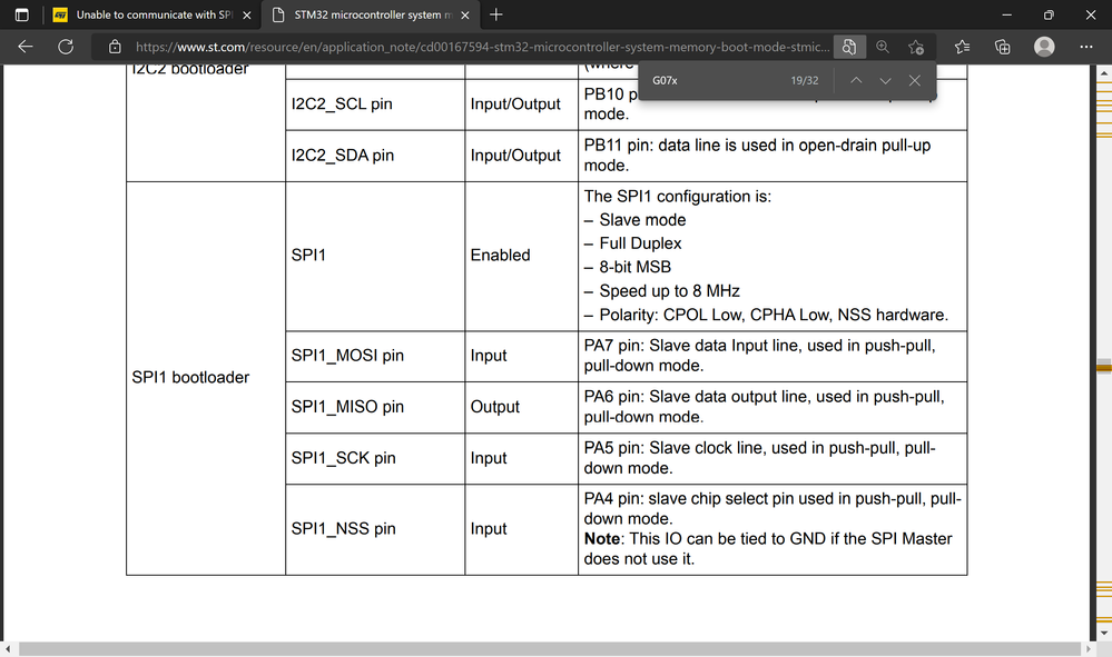

Check your connect config to G071 is
0693W00000NsjxSQAR.pngor SPI2 on next page.

The master spi config is correct so far. I used the CubeMX configuration for SPI on master side with CPOL Low, CPHA Edge 1, MSB first 8bit. Using the master code from the linked repo I am calling BL_Init a moment after I am sure the slave uC has entered the BL. Is there specific timing to adhere to? I am not using any other periphery to connect to the BL. I can see that the bootloader sends a dummy while the master sends the sync byte. However after that the master loops in wait_for_ack() because the bootloader just sends garbage data while the master sends dummies
