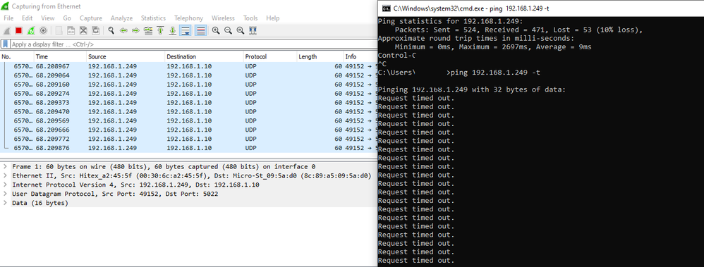

After some seconds/minutes my MCU get rested( I receive correct data before and after resting). It makes me crazy. I can't understand why?
I call SetSCK() when after 300us socket is failed(Socket<0). what is my mistake?
In addition in some situations while I am receiving the correct data, my mcu doesn't respond to ping command.(I have set the IP at Net_Config_ETH file).

Yes, You are right. But I can't understand how this happens. Because by setting (IWDG_Prescaler_32)( Fr=40000/32=1250 hz) and IWDG_SetReload(200); it takes more than 160ms to set the watchdog flag. In while loop (IWDG_ReloadCounter();) is placed which resets the watchdog before 160ms. what is my mistake?
In my point of view the above process clears watchdog flag so faster than 160ms( because each 100us it sends 16 bytes in while loop).

But I need to know more, When my UDP sender sends each 100microS with DMA, why this loop takes more than 160ms?Because the heaviest function (Ethers
) doesn't do anything special.

I disabled the watchdog and added a Pin for counting the delay between the commands.
GPIO_SetBits(GPIOC,GPIO_Pin_10);
		if(Alarm==1)
			Alarm=0;
			Ethers();
		if(CheckAlarm>2)
			netUDP_Close (socket);
			netUDP_ReleaseSocket (socket);
			SetSCK();
			CheckAlarm=0;
		GPIO_ResetBits(GPIOC,GPIO_Pin_10);
I see that the maximum delay ( when Pin is high to being Low) is about 50us( 1us<t<50us). It is too strange.
