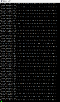

I started with your data acquisition snippet. From there, I went and pasted every one of the 25 bytes from the current frame one after another into the serial terminal. To my surprise, the "0x0F" or decimal 15 was nowhere to be seen, and most definetly not around buf[0].
Below image shows the serial terminal, it notifies for a new frame with its buf[0] and then just throws out all 25 values (beginning, again with buf[0]), raw and untouched yet from any conversion. For the sake of reading, it waits a second until it pastes the next fresh frame. Leaving that last step, meaning the delay, out doesnt change a thing as it seems.

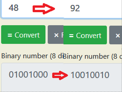

Addition: Notice how some frames have their buf[0] be a specific value after the frame notification, and then are pasted with a different buf[0] as the whole frame is pasted. Looks weird to me - does that mean the frame gets overwritten in the meantime because pasting it via serial takes too long between each frame or is that a timing issue?
For example this, buffer0 being 48, in the whole pasted frame 92.
Seems shifted to the right I guess?

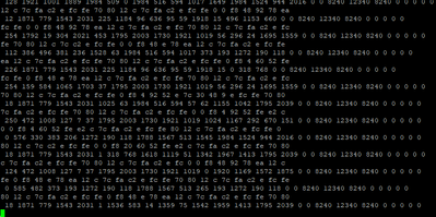

I am now performing conversion after each frame is received and output both raw hex values and their actual converted values (the relevant data per channel). Signal trace is as short as can be. Still no real structure behind all that...
Channels 1-16 all give results in their expected range, while being seemingly random (the transmitter remains totally still as is not being manipulated).

Now that i look at your screen capture of the data, you can see there is a repeating pattern but they are out of sync. Take for instance the first line that starts with 0xE, 0xFC, 0xFE, 0x70, 0x80, 0x12, 0xC.... The same patter can be seen on other lines but 0xE starts at another index.
Now 0x0F isn't seen so something is still not correct. But the first byte of the packet whatever it may be, should be the first in byte[0]. I'd check with an Oscilloscope to see what is the actual first byte
I'd get away from using HAL_UART_Transmit as that is blocking code and so you could be missing receiving bytes. Use HAL_UART_Transmit_IT instead.

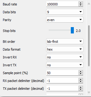

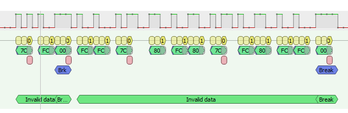

Here are a few snaps from a SBUS signal that I acquired directly from the receiver, without the STM32 (solely as power source). Config-window for SBUS decoding:
These are the SBUS decoding settings, I tried every combination imaginable, first and foremost 100000kbps, 8, even parity, 2 stop bits. Switched Inverted/not inverted. 8/9 bits. Even/uneven. But all that made no difference - what follows are frames taken with several different settings where it's mostly inversion that was changed in the decoding options. Values stay untouched, so the upper "line" is always the raw, unedited signal.
As you can see in this and some following screenshots, there are some repeating patterns again, yet the same phenomenon, the "wandering", occurs too.
Am I the only one finding those frames a little short for 25bytes?
I can't even decipher more than two bytes out of most of those frames. Or is that because every byte is transmitted seperately (which, the more thought I give it, sounds somewhat plausible)?
I am 100% sure that the data line is hooked up to the SBUS-Out pin on the Receiver.
Now, there is the option to declare the "SBUS paket length" which I then tried setting to 25, 24 but that did not give me any good results either. I can try it with 16 or other values tomorrow, but as of right now it looks like a dead end.
