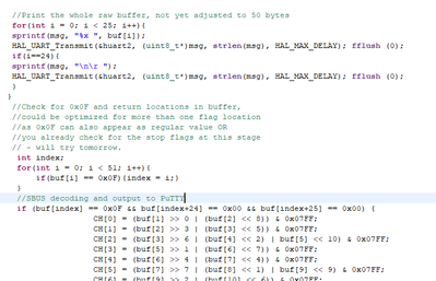

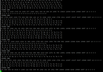

A small success:
After doubling the rx buffer up to 50 bytes and looking for the start flag, then transfering the index of the flag in this buffer to the SBUS-Yes/No?-Check I was able to achieve pretty regular lock-ons directly after resetting the MCU by hand. Unfortunately only then. But hey.
It is far from perfect still, but better than yesterday. Tomorrow I will have the time to read deeper into what you kindly suggested to further improve my concept; Interrupts especially. Any ideas for further lecture?
@StefanRinside my while-loop:
This could be an easy and combined with other strategies fast way to combat shifting.
