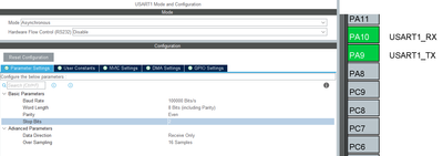

CONCLUSION: Since the serial communication itself works, but neither gets any values nor notifies for a new frame, I think the issue lies within the SBUS -> UART part of it. Means, the Callback doesnt get executed for whatever reason. Additionally, here's my .ioc:
Iv'e tried it with 9 or 8 bits word length, but that doesnt change anything. Since FrSky is using the Inverted-SBUS, which is inverted itself (0->H, 1->L), I figured the data polarity is correct aswell as the jumper wires and config settings on the RX.

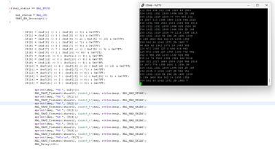

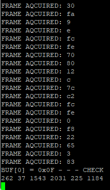

Thanks for the detailed analysis where to look. Via several basic flags to my PCs serial terminal I was able to "debug" it a little via Putty. As it seems, it does receive data - just not useful one. It receives changing, seemingly random values. Now, only 1 out of 100 matches the "0x0F" flag required for SBUS decoding; when this flag is received it converts the rest of the data as expected and throws some values. It appears to me that UART is having difficulties locking into the frame at the beginning or so. Reading out the first buffer value, it often says "0x7C", which is something like 1111100. Remember that SBUS starts a frame with "0x0F" which translates to 00001111 - Maybe the signal is indeed still inverted, against my expectations. Will update.

Moving on - I copied your code, inserted my conversion snippet and tried it out:
It seems like most of the time, nothing changed too much - it's still picking up mostly random values. But by moving the sticks on the transmitter, I can occasionally (and not repeatedly) provoke a "valid" frame that leads to conversion and value output. To be fair, that worked before, too.
What I don't understand is this: SBUS is originally "inverted" to 1=LOW (confirmed by two independent sources, yet another one says the opposite). FrSky apparently chose to invert SBUS again to what I figure is 1=HIGH. As per definition, UART is 1=HIGH aswell so I should not  need an inverter. It seems like the MCU does receive frames via UART, it just somehow is missing the "00001111" flag as Byte1 of the frame or buf[0] in my code. Is there anything to this I am still missing?
A variant that doesn't check for the start flag and just converts the input to its according SBUS values doesnt give me conclusive behavior:
If filtered by buf[0]=0x0F, the occasional result yields no better values.
Is it maybe signal degradation due to the baud rate being 100k and the bread-board cable I use between the Rx and the STM32 being 20cm long?
Am I totally wrong about UART and indeed do need to use an inverter?
