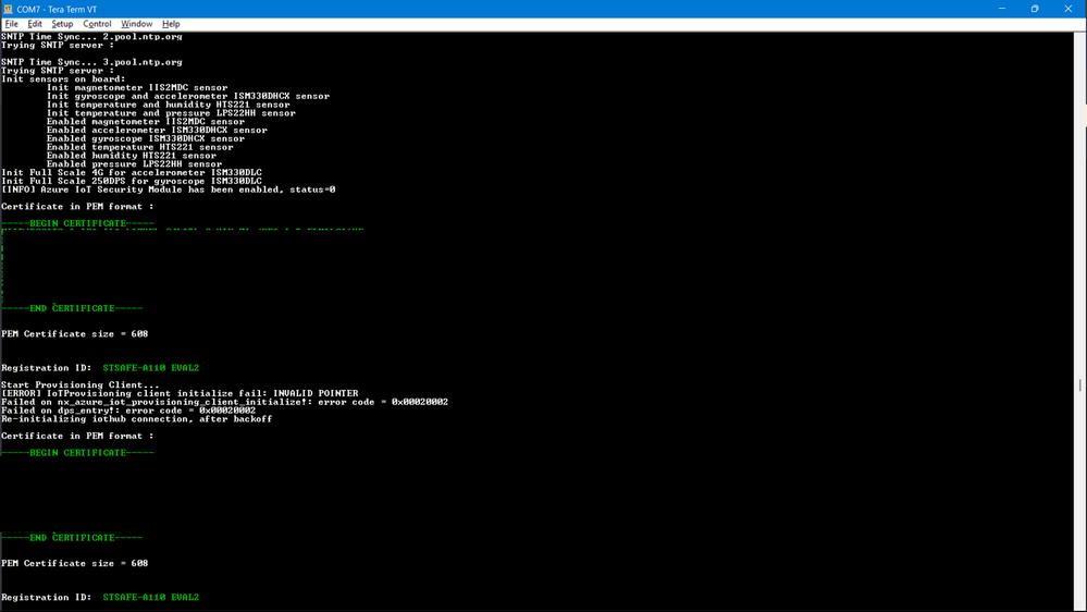

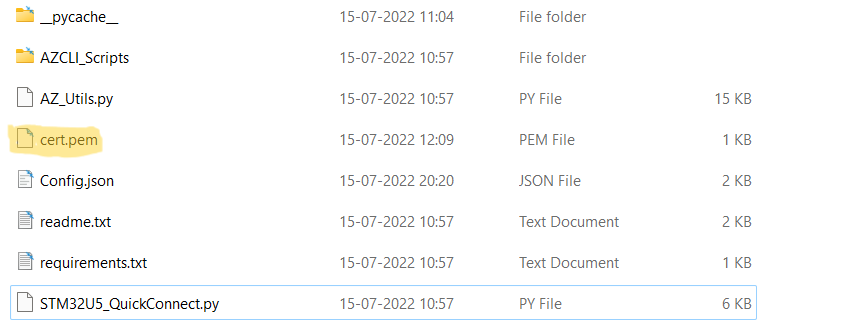

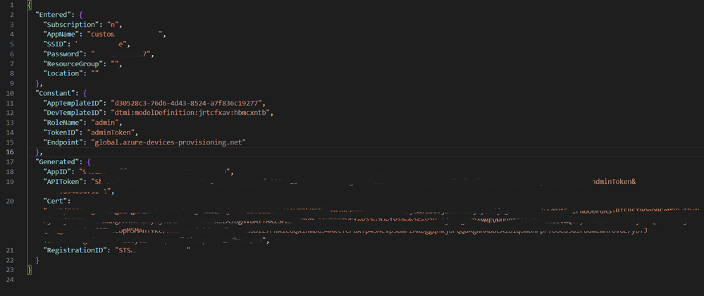

4.This was my config file after running STM32U5_QuickConnect.py and entering all the details
5.Certificate file was also made successfully

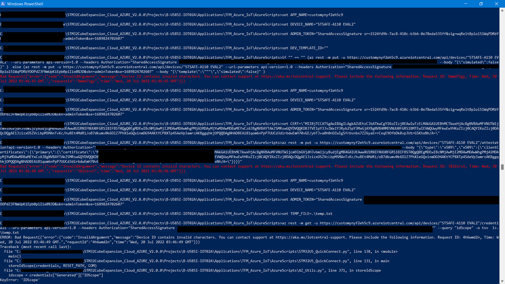

6.But still share error was coming
Bad Request({"error":{"code":"InvalidArgument","message":"Device ID contains invalid characters. You can contact support at aka.ms/iotcentral-support. Please include the following information. Request ID: 5t53jg92, Time: Thu, 14 Jul 2022 08:37:19 GMT.","requestId":"5t53jg92","time":"Thu, 14 Jul 2022 08:37:19 GMT"}})

- Did you manually change Config.json file in order to put your own Application Template Id and Device template Id?

I hope by logs you mean this:
And to answer your questions:
- registration id have alphanumeric, one dash, and one space
- I have tried both ways with and without changing the config.json file manually in order to put the Application Template Id and Device template Id
After trying manually it is looping on the following step giving an error:

As we can see on your logs, the Registration ID contains a space which is not allowed by IotHub for DeviceID field.
Unfortunately, the board your are using will not be compatible with this application because it seems to have an old STSAFE-A110 device version. Only the STSAFE-A110 with SPL03 profiles are compatible. They integrate a unique ID in the common name certificate, with valid characters for cloud based solutions. (STSATE-A110 SPL03 Application note).
To be compatible with this application, Registration ID printed should be "eval3 – Unique serial number", for example “eval3-0209A0949081D4C16B0139�?
