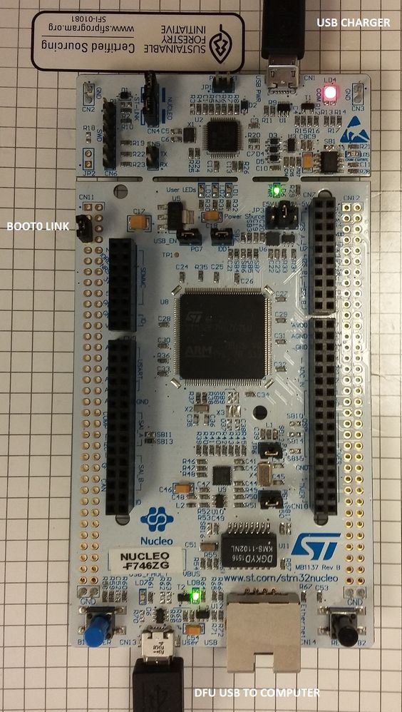

I have the cable plugged into the one at the top. I have boot0 -> Vdd jumper. I thought one at bottom was for application program usage.
‎2020-04-06 12:41 PM
When I plug into bottom USB connector (next to ethernet) the board has no power. Do I need both plugged in?
‎2020-04-06 12:57 PM
See picture, I'm powering it via a USB Charger. There's probably a way to jumper it, but I'd have to RTFM
