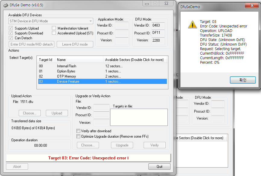

i also ended up trying STM32CUBE's DFU ( example source )
Computer does identifies STM32 in DFU mode, with CODE 10 error ( Cannot start device )

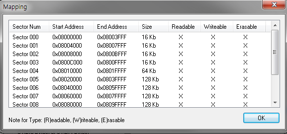

it works! kind of,
thought i cannot upload anything
i think it's because Internal flash, option bytes, otp memory, device features address are non readable/writeable/eraseable,
I'm trying to find out why!
