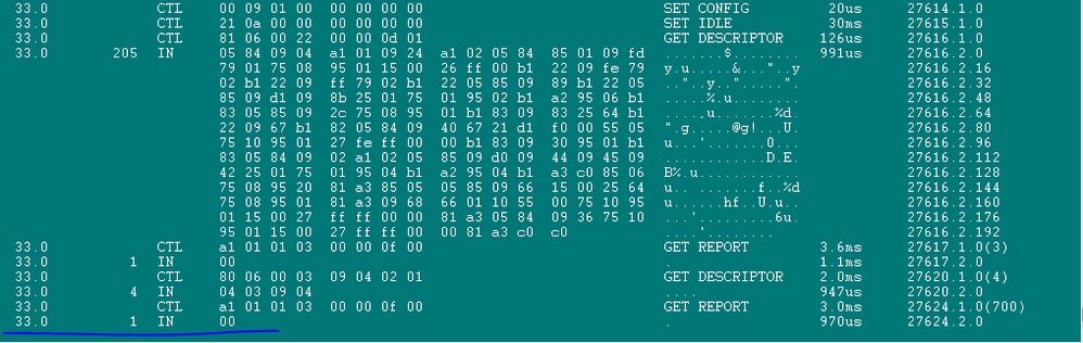

If I don't change the original code:
The result of usb communication is this:c00000004 stall pid.I guess because original code not have handle "get report".My request in host by feature.

But the device only responded with a data 0.
I don`t know why?

‎2023-03-02 2:06 AM
Now is OK.
uint8_t *CustomHID_GetReport_Feature(uint16_t Length)
if (Length == 0)
pInformation->Ctrl_Info.Usb_wLength = Size ; //The size is your data length.
return NULL;
else
return (uint8_t *)(&report[0]);
I don't know why.Because I think it had return.But it's ok.!!!???
