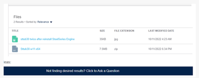

I'm a developer and need a working version of the Sttub30 .sys. Deletion is no solutio be cause we need to use it.
All references to a Sttub30-w11-x64 from 2015 with newer version that is compatible with core isolation.
But everything was deleted, because it was missused for MSI bluescreens.
The new DFU tool is No solution, because the driver device ID has changed and it needs complete other tools and driver and protocols.
We can not update all devices for the new tool.
PLEASE. This one screenshot is the only hint that is left of the driver in the hole internet:

@cpryor This driver is no longer needed. In modern Windows one should use winusb. To support older products, perhaps install a dedicated Windows PC with the integrity checks disabled. Or a Linux machine where this issue does not exist at all. Your IT can help you with this.

Thank you peter for your reply.
The problem is, that there is no OS FutureDescriptor in the original DFU SE sample code. (I could add, but that does not change tousand devices at customers)
Even if i assign manual a winusb driver, the dfuSE Demo 3.0.6 is not searching for winusb devices and is it not listing it.
And this forcing on customer pc's will be very difficult because of needed inf, that needs sinature and licensing from Windwows.
Could you please try to find this working driver version? Somebody from your company must have it.
