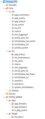

I'm trying to debug new thread ftd project. You can find my settings below:
- HSEM
- IPCC
- RCC -> HSE/LSE
- SYS -> Serial wire
- RTC
- LPUART1 & LPUART1 DMA
- USART1 & USART1 DMA
- RF
- STM32_WPAN as a THREAD
When I debug it, It gives me a lines of errors. You can find my errors below:

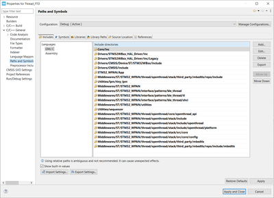

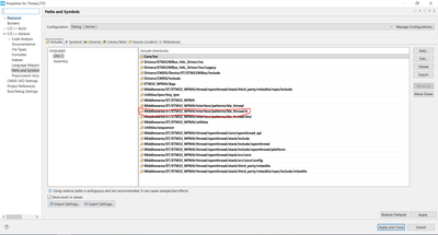

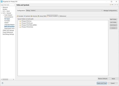

Paths to source files (*.c) are listed in the "Source Locations" tab, not the "Includes" tab.
Typically including only the top-level directory is sufficient there, as it will crawl to subdirectories.
From your post a few up, it looks like you are missing an entry for "/FTD_Thread/Middlewares", which is where your file is located.
You could also remove them and add only "/FTD_Thread".

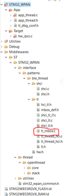

Did you try to add the missing files into the src and inc folders if this resolves the issue then you have some problems with your paths it will help if i could have a version of your code to try and resolve the issue .
BR
Hi @STea ,
There are no missing files.
As you can see, all files already inside the folders but my projects doesn't see them.
I think that my paths and source locations are also correct too and I didn't write a code or change any code in my files. I just create my project and configure my IOC file.

Mickey_Piper
Hi @AScha.3 ,
Thank you for your response. Actually I follow the .h files that include missing functions and I saw that all necessary libraries already included so I thought this is not a problem.
For example this error:
C:/Users/a.e/Desktop/STM32Workspace/Thread_FTD/Debug/../STM32_WPAN/Target/hw_ipcc.c:423: undefined reference to `HW_IPCC_THREAD_CliEvtNot'
This error says it cannot find "HW_IPCC_THREAD_CliEvtNot" function in "hw_ipcc.c". I follow the function and find it in "hw.h" file. When I check the "hw_ipcc.c" file I found this includes:
#include "app_common.h"
#include "mbox_def.h"
and inside the "app_common.h" library it included this library:
#include "app_conf.h"
and "app_conf.h" file have this libraries:
/* Define to prevent recursive inclusion -------------------------------------*/
#ifndef APP_CONF_H
#define APP_CONF_H
#include "hw.h"
#include "hw_conf.h"
#include "hw_if.h"
so as you can see the necessary library already included.
Best regards.
Where is HW_IPCC_THREAD_CliEvtNot defined? Not declared, but defined? You need to ensure that file is being compiled. Typically the definition is in a *.c file and the declaration is in a *.h file.
This is not an include file issue, or the error would be during compilation, not linking. You are seeing linker error.
Mickey_Piper
Hi @TDK ,
I understand you and I check the definition of functions. For the previous example I mentioned, the function declaration in "hw.h" file. I check the files and found the definition in "tl_mbox.c" file in Middlewares -> ST -> STM32_WPAN -> interface -> patterns -> ble_thread -> tl folder. I check my folders and found the "tl_mbox.c" file in exact folder as you can see below:
and check my Paths and Sources again. Found that it already included:
Best regards.
