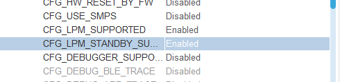

I am writing an embedded software project that includes BLE GATT protocol with stm32wb15 mcu.
Based on the "BLE_HeartRate" example, to use stop1 and standby in the project;
I activated "CFG_LPM_SUPPORTED 1" and "CFG_LPM_STANDBY_SUPPORTED 1".
Question 1
I closed all debugs in Cubemx. I am using Custom Template.
I have not yet activated and added peripherals such as IO, UART, I2c to the project.
I have a board that I designed with a processor and I am measuring with a multimeter that measures nA level.
When I load "BLE_HeartRate" to the device, I see a consumption between 90uA and 450uA. After a certain period of time, this value drops to 90uA and 138uA. These are values ​​much higher than the consumptions mentioned in the documents.
What is the possibility of hardware losses? Or do I need to add to the "BLE_HeartRate" example?
The problem in my project is as follows;
Sample Project in this link;
https://www.youtube.com/watch?v=CKYWy7LKL68&list=PLnMKNibPkDnG9JRe2fbOOpVpWY7E4WbJ-&index=16
- "CFG_LPM_SUPPORTED 1" and "CFG_LPM_STANDBY_SUPPORTED 1" are not active, 2.5mA
- Only "CFG_LPM_SUPPORTED 1" is active, I read 170uA and 450uA values.
- When I activate "CFG_LPM_SUPPORTED 1" and "CFG_LPM_STANDBY_SUPPORTED 1" at the same time, I see the 2.5mA values ​​again.
What do you think is the problem?
Do I need to add extra code?
