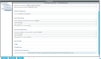

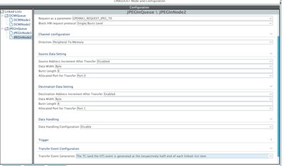

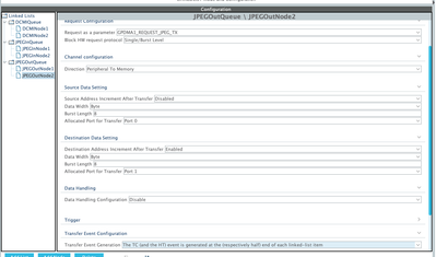

    I'm capturing image as RGB565 using camera over DCMI on DMA. Capturing is complete and data is available. Now I need it to convert into JPEG format.
    But, the JPEG in/out DMA is not working. Any help will be appreciated.

	MX_DCMIQueue_Config();
	HAL_DMAEx_List_LinkQ(&handle_GPDMA1_Channel12, &DCMIQueue);
	__HAL_LINKDMA(&hdcmi, DMA_Handle, handle_GPDMA1_Channel12);
	MX_JPEGInQueue_Config();
	HAL_DMAEx_List_LinkQ(&handle_GPDMA1_Channel13, &JPEGInQueue);
	__HAL_LINKDMA(&hjpeg, hdmain, handle_GPDMA1_Channel13);
	MX_JPEGOutQueue_Config();
	HAL_DMAEx_List_LinkQ(&handle_GPDMA1_Channel14, &JPEGOutQueue);
	__HAL_LINKDMA(&hjpeg, hdmaout, handle_GPDMA1_Channel14);

    Thank you for your response. I have been able to encode a 320x240 RGB565 image. But My application requirement is to encode 640x480 RGB656 image to JPEG.
    The example here demonstrates linear DMA but, as my application requires handling data size larger than a linear DMA can handle, I need to use linked-list DMA. Can you please guide me how can I implement that. Any example or documentation available for the particular purpose? I have configured the DMA following AN5593 and RM0456.
    The stack-dump at the error is attached hereafter, would like to know what might be the cause. The particular error flag I can view on debugging is HAL_DMA_ERROR_TE.
