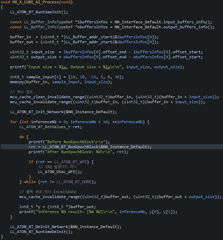

I am currently using the STM32N657-DK board with X-CUBE-AI (ST Edge AI Core v2.2.0).
I have successfully converted a TensorFlow Lite model to run on the NPU and can build and flash the firmware without issues.
Problem
When I call the function
ret = LL_ATON_RT_RunEpochBlock(&NN_Instance_Default);
it never returns.
The variable ret never reaches LL_ATON_RT_DONE, and it seems that the NPU interrupt (NPU3_IRQn) is not triggered.

Questions
  1. Is any additional RISAF or RIF configuration required to allow the NPU to generate interrupts in a NonSecure environment?
  2. To enable Epoch Controller interrupts, do I need to explicitly configure ATON_INTCTRL registers (e.g. ATON_INTCTRL_CTRL_SET_EN, ATON_INTCTRL_INTORMSK0_SET), or should X-CUBE-AI handle this automatically?
  3. Could this issue be related to the memory attributes of the NPU region (cacheable vs. non-cacheable)? If so, what configuration is recommended?
  4. Are there any known issues with NPU interrupt routing (NPU3_IRQn) in Secure/NonSecure TrustZone projects on STM32N6?
Thank you very much for your support.
